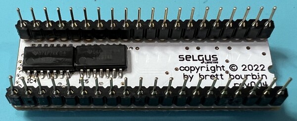

Good to hear it. Two years ago I assembled similar adapter but using standard DIP IC packages. It works pretty fine in my 800XL but sometimes system going to halt state. I'll try to find it and run again with 65XE for tests...
Regards,

pancio schrieb: Hi
Regards,

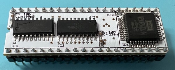

I like the idea of the W65C02S6TQG-14 😎 . A clock of 14 MHz maximum also means lower heat development at 1.79 MHz 😎 .

Kveldulfur schrieb: Warum ein TQG und nicht ein TPG? ->https://www.reichelt.de/8-bit-65x-mikroprozessor-14-mhz-1-8-5-25-v-pdip-40-w65c02s6tpg-14-p319384.html
Ich mag es lieber wenn DIP-Chips genutzt werden 😀
Grüße Janko
Hi Janko, ganz einfach: Aus Platzgründen 😉...
Ja stimmt schon... aber das sieht dann alles nicht mehr so schön Retro aus... 😁
Grüße Janko
Zwischen VBXE, Sophia, PokeyMAX und U1MB fallen DIP-Chips schon fast eher auf... 😁

Hi Carsten, ja, ich denke, das wird der sein, von dem Pancio gesprochen hatte:
pancio schrieb: Hi
Regards,
Exactly! this is this device which you shown :-)

Unfortunately not. This is only successor for Sally but.. it's not fully compatible e.g. if you are using programs which contains illegal/6502C specific OP codes.
pancio schrieb: Unfortunately not. This is only successor for Sally but.. it's not fully compatible e.g. if you are using programs which contains illegal/6502C specific OP codes.
Programs with illegal (undocumented) 6502C specific opcodes - you will get XXL problems then... 😉 Alas, there are more than just a handful of them. (And there are many more such programs, than programs using e.g. separate Antic.)
